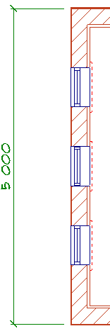

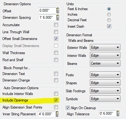

Include Openings option added. De-select this to exclude placement of the Extension Lines from Openings as is the drawing standard in Australia.

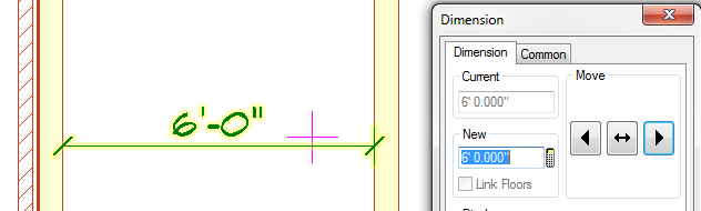

Edit
The Edit dialog Move arrow is automatically selected and highlighted based on the cursor location on the dimension line when edit was selected.  In the example above Edit was selected at the pink cross , right of the dimension number, the Move right button was selected and highlighted by default therefore eliminating the step of selecting the direction.

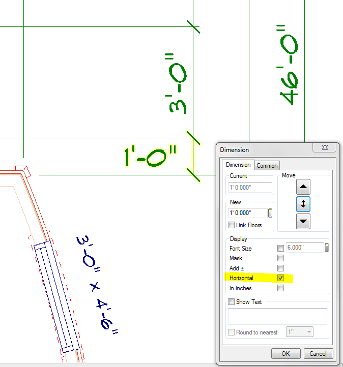

Horizontal option added
When selected all dimensions will "read from bottom" regardless of orientation, used frequently on cabinet drawings.

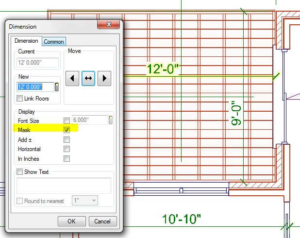

Mask Option added
Mask option added to Dimension edit removes all items "under" the dimension on the screen making the Dimension easier to read.
